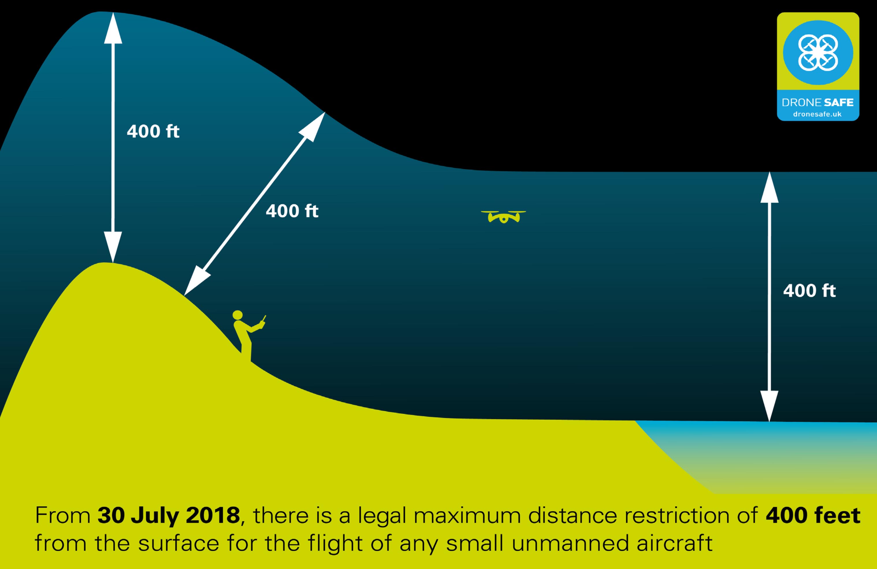

You can do it with respect to actual ground, so long as you stay within a 400ft bubble of the ground (so you can fly off a cliff/hillside out into a valley, but you must remain within 400ft of the nearest ground) - Natural terrain. The surface doesn't include buildings or structures, only natural features. So, you'd need to apply to the CAA for an additional OSC/Perrmission.
From CAP1687:
To cater for the few occasions where a small unmanned aircraft is being own over hilly/undulating terrain or close to a cliff edge, the 400 ft height above the surface requirement may be interpreted as being a requirement to remain within a 400 ft distance from the surface, as shown in the diagram below. For the purposes of Article 94A, this is considered to be an acceptable means of compliance with the legal requirement.
Remember that the limitation applies to ‘heights above/distances from’ the surface of the earth. It does not automatically apply to heights/distances from tall buildings or other structures: in such cases, an additional permission from the CAA will be required, which will invariably also require permission to operate within a congested area.
Just noticed, the surface of their sea isn't level o_O:rolleyes::D:D:D:D

From CAP1687:
Haha LOL i noticed it too :D
